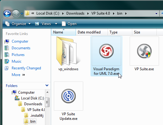

Setting up software with no install package

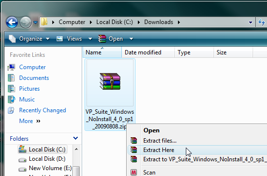

- Unzip the no install package.

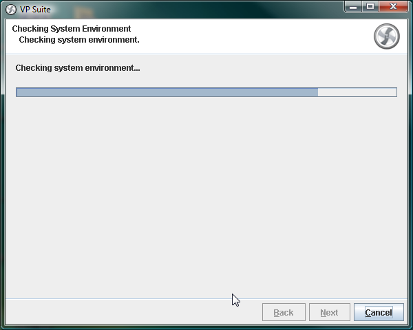

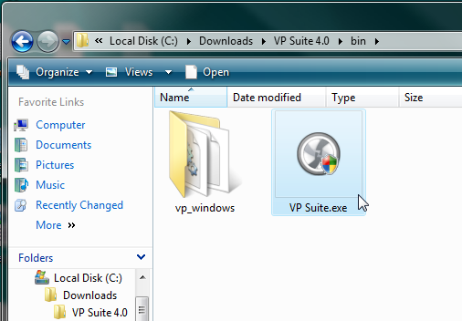

- Go to the bin folder and execute the VPSuite.exe.

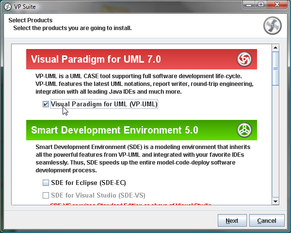

- Select the Visual Paradigm for UML (VP-UML).

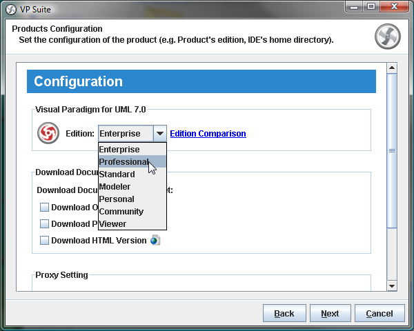

- Select the Edition you like.

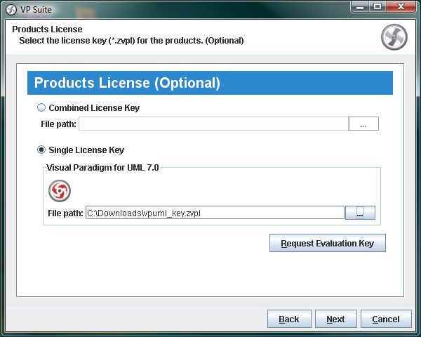

- Specify the license key file (this step is optional, you can import the license key later on).
- Click Next to complete the process.
- You can launch the software when the configuration complete, or execute the shortcut at the bin folder to launch
